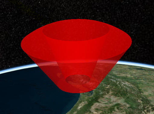

new IonSdkSensors.ConicSensor(options)
Visualizes a conical sensor volume taking into account occlusion of an ellipsoid, i.e., the globe, or the environment, i.e., terrain and models. The sensor's shape is defined by inner ConicSensor#innerHalfAngle and outer ConicSensor#outerHalfAngle cone angles, minimum ConicSensor#minimumClockAngle and maximum ConicSensor#maximumClockAngle clock angles, and minimum ConicSensor#minimumRadius and maximum ConicSensor#maximumRadius radii. A nonzero minimum radius carves an inner cutoff from the volume, capped by an inner dome surface, as shown in example 4 below. The sensor's principal direction is along the positive z-axis. Clock angles are angles around the z-axis, rotating x into y. Cone angles are angles from the z-axis towards the xy plane. The shape also depends on if the sensor intersects the ellipsoid, as shown in examples 2 and 3 below, and what surfaces are shown using properties such as ConicSensor#showDomeSurfaces.
Code Example 1 below
Code Example 2 below
Code Example 3 below
Code Example 4 below
A sensor points along the local positive z-axis and is positioned and oriented using ConicSensor#modelMatrix.

Examples:
// Example 1. Sensor on the ground pointing straight up
const sensor = scene.primitives.add(new IonSdkSensors.ConicSensor({
  modelMatrix : Cesium.Transforms.eastNorthUpToFixedFrame(Cesium.Cartesian3.fromDegrees(-123.0744619, 44.0503706)),
  radius : 1000000.0,
  innerHalfAngle : Cesium.Math.toRadians(5.0),
  outerHalfAngle : Cesium.Math.toRadians(85.0)
// Example 2. Sensor pointing straight down with its dome intersecting the ellipsoid

// Example 4. Sensor with minimum and maximum radii
  maximumRadius : 1000000.0,
  minimumRadius : 400000.0,
  innerHalfAngle : Cesium.Math.toRadians(20.0),
  outerHalfAngle : Cesium.Math.toRadians(35.0)
See:
