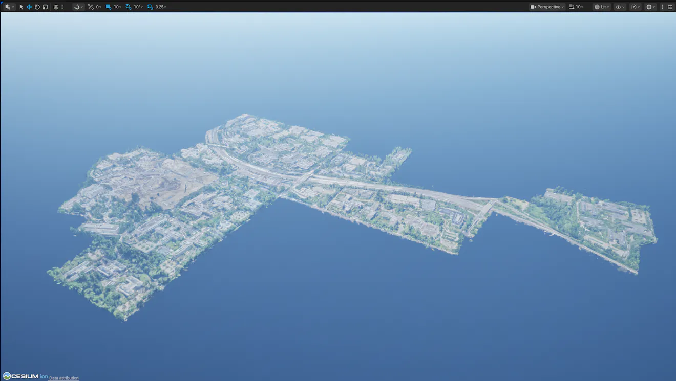

3D Gaussian splat tileset of the Microsoft Redmond Campus, shown in Unreal Engine with Cesium World Terrain. Captured in partnership with Bentley Systems from 20,169 photos (427.7 gigapixels), covering approximately 3.7  square km with 110  million splats. This dataset is used as a reference for focusing the actor at the center of the viewport.

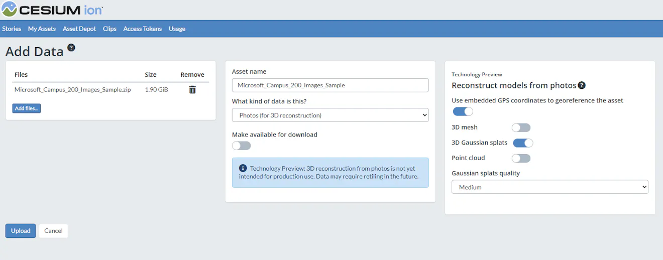

(Optional) Create a Gaussian splat dataset in Cesium ion
This tutorial assumes you have a Gaussian splat tileset available in your Cesium ion account. If you need to create one, follow the tutorial to create 3D reality models from photos.
 When exporting your dataset, select Gaussian splats as the output type.

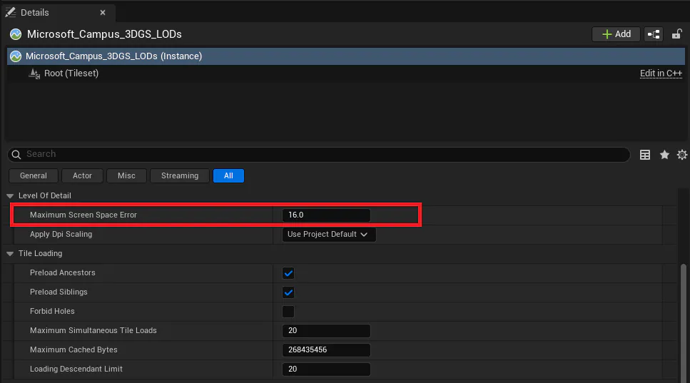

The Maximum Screen Space Error setting can be found in the Details pane in your Unreal Editor.
Maximum Screen Space Error has an inverse relationship with LOD. Higher values result in lower levels of detail staying in view for longer, which favors performance. Conversely, lower values force higher LODs to load, which increase visual fidelity at higher GPU cost.

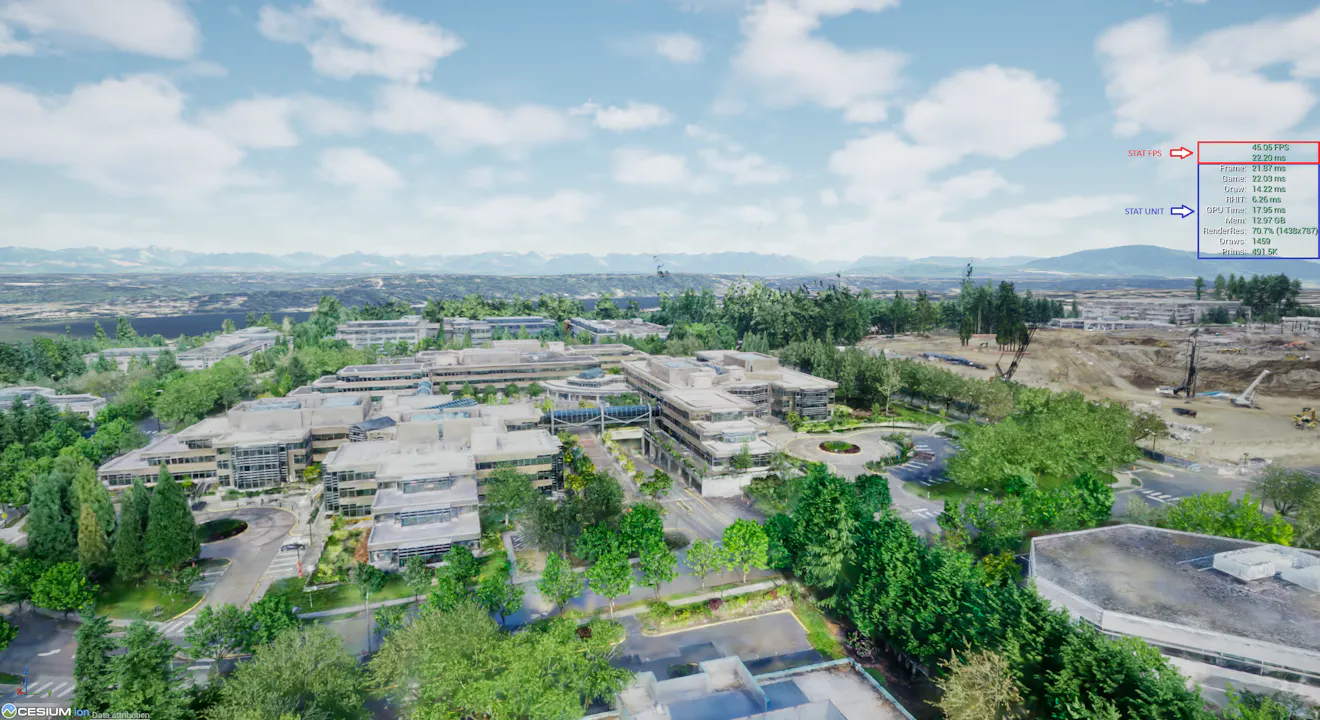

4Monitor performance in Unreal Engine
Unreal Engine provides various tools out of the box to profile performance in your application. Open the in‑editor console (~) and run:
  1. stat fps
  2. stat unit
Open the in‑editor console (~) and run stat fps and stat unit.
Information
Because Cesium for Unreal uses Niagara under the hood to render splats, you can also run “stat Niagara” to view the current memory consumption of the on-screen splats. This can help inform the Maximum Screen Space Error you choose, as well as other options to optimize your level for Gaussian splats.
