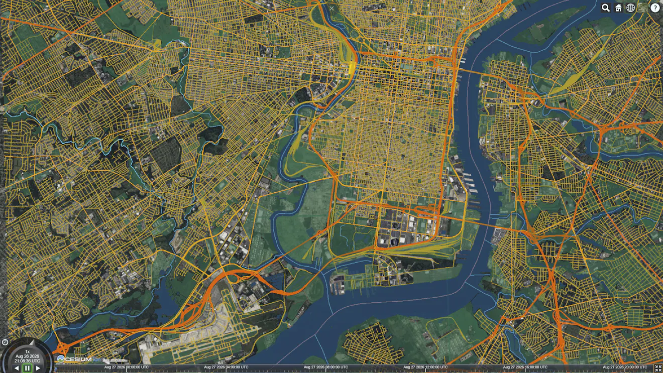

4Style MVT features
MVT Philadelphia
Each rendered feature retains the attributes stored in its MVT layer. These attributes can be referenced directly through Cesium3DTileStyle.
The following example styles roads according to their class property:
provider.tileset.style = new Cesium.Cesium3DTileStyle({
  color: {
    conditions: [
      ["${class} === 'motorway'", "color('#ff6b35')"],
      ["${class} === 'primary'", "color('#f7c59f')"],
      ["true", "color('#cccccc', 0.6)"],
  lineWidth: "${class} === 'motorway' ? 4.0 : 2.0",
Property names are preserved when the tile is decoded. Expressions such as ${class}, ${name}, and ${population} therefore refer directly to MVT attributes with those names.
Property names are case-sensitive and must match the names in the source tiles exactly.

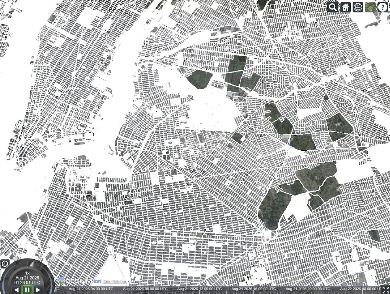

Supported styling properties
The available style properties depend on the feature’s geometry type.
Geometry typeSupported style properties
Pointscolor, show, pointSize, pointOutlineWidth, pointOutlineColor
Linescolor, show, lineWidth
Polygonscolor, show
The show property can also be used to control feature visibility based on an attribute.
  show: "${population} > 100000",
This example displays only features whose population property is greater than 100,000.

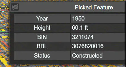

5Pick a feature and inspect its properties
MVT feature table
MVT features use the same picking workflow as other 3D Tiles content. Use Scene.pick to retrieve a feature at the selected screen position, then read its properties.
const handler = new Cesium.ScreenSpaceEventHandler(viewer.scene.canvas);
handler.setInputAction((movement) => {
  const picked = viewer.scene.pick(movement.position);
  if (!Cesium.defined(picked)) {
    return;
  for (const id of picked.getPropertyIds()) {
    console.log(`${id}: ${picked.getProperty(id)}`);
}, Cesium.ScreenSpaceEventType.LEFT_CLICK);
