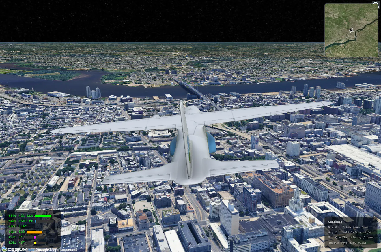

Now for the main feature. Send a detailed prompt describing what you want:
Prompt:
Build a simple flight simulator using the globe we’ve just built.
The interface should show a 3D model of a commercial airliner, with a third person camera that tracks the motion of the plane. The UI should have controls for the aircraft (throttle, pitch, and roll) controlled with the keyboard and displayed on the screen. The plane should start flying over Philadelphia at 2,000 feet, headed towards New York City. Add a minimap overlay so I can see where the plane is on a map. Use a small plane icon to show heading and leave a trail on the map so I know where we’ve flown.
Note: When debugging visual issues, describe what you see rather than guessing at the technical cause or attach screenshots to your prompts. Let the agent diagnose: it often has better context about what the code is doing. You may need to instruct your agent to correct problems like the plane model facing the wrong direction, or controls being reversed from what you might expect. After this first prompt, take a moment to describe anything that isn’t working as you’d like and work with your agent to correct the issues.
