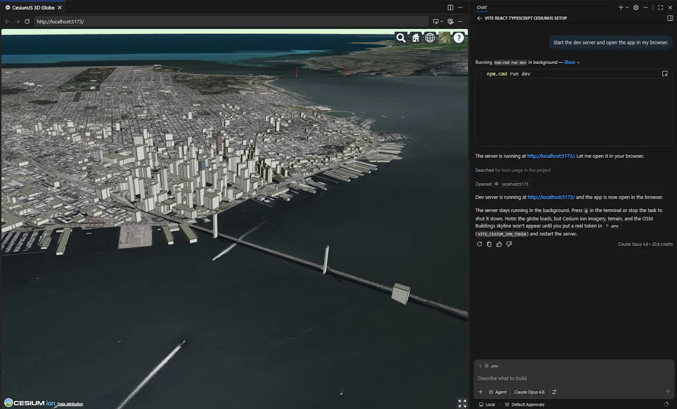

Prompt 3: Start the dev server
Start the dev server and open the app in my browser.
At this point you should see a view of the globe, looking at San Francisco, in your browser.
