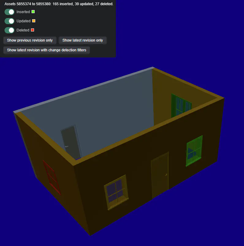

Change Detection for BIM/CAD Models with Cesium ion API
In this tutorial, you compare the latest two versions of a BIM/CAD Database model and visualize inserted, updated, and deleted elements in CesiumJS.
Screenshot of a completed change detection demo showing toggles to highlight different changes, new/inserted elements are currently highlight green.

What you'll build
The finished application:
  1. Discovers the two latest related 3D Tiles assets.
  2. Retrieves a comparison created in advance in Cesium ion.
  3. Downloads the complete comparison report.
  4. Highlights inserted elements in lime, updated elements in orange, and deleted elements in red.
  5. Switches between the previous revision, latest revision, and latest revision with change detection filters.
  6. Provides filter controls with matching color swatches, plus a status message with change counts.

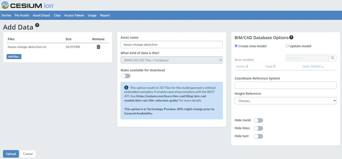

1Prepare two model versions
Process the original model
In Cesium ion, add your BIM/CAD model and select BIM/CAD Tiler with Database. Wait for the resulting 3D Tiles asset to finish processing.
Ensure you select "BIM/CAD (3D Tiles + Database)" if you are uploading your own files, if you can't that means that file type isn't supported. Ensure you select "Create a new iModel" for new datasets. You can find information on supported file types for the BIM/CAD Tiler with Database here.
Models added from Bentley Infrastructure Cloud also support this workflow. To import multiple versions of one of these models, repeat the import through the POST /v1/assets/imodel route and pass the changesetIndex of each version to import, when omitted the latest changeset is imported. The changesetIndex parameter is currently experimental. In either case, the result must be backed by a BIM/CAD Database so Cesium ion can associate related versions and compare their elements.
If you have chosen to add from Bentley Infrastructure Cloud then you can go to My Assets > Add Data > Add from Bentley Infrastructure Cloud, then search or enter your iModel ID. You can find the guide on Importing Models from Bentley Infrastructure Cloud here.
You will have to wait until the 3D Tiles asset has finished tiling before you can proceed.

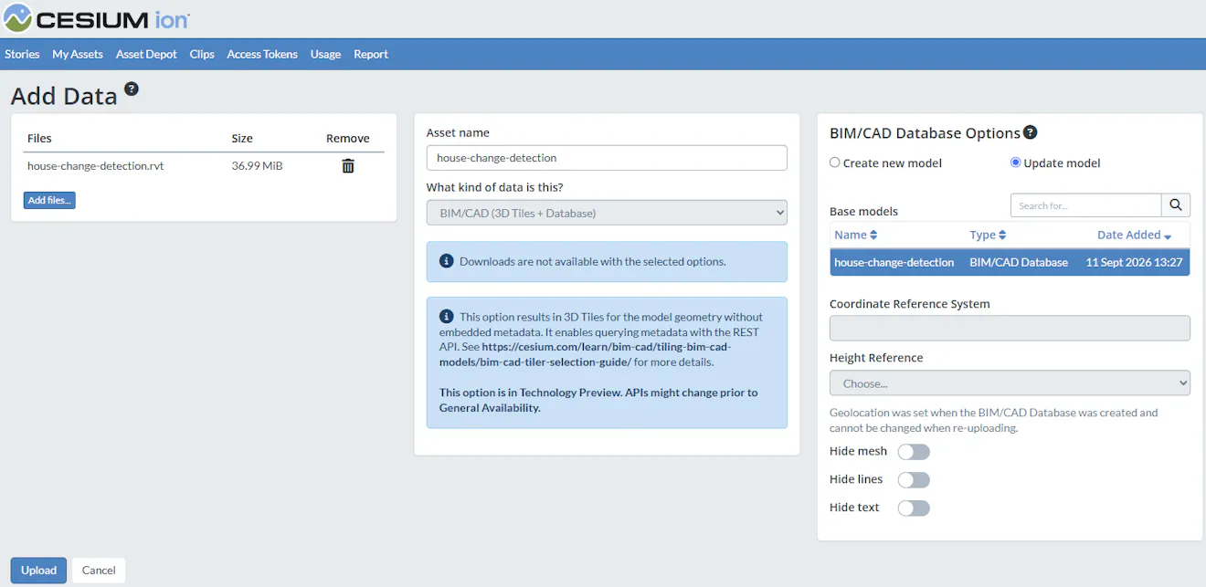

Make a revision
Update the source model with one clear example of each operation:
  • Add an element that should be reported as inserted.
  • Change an existing element that should be reported as updated.
  • Remove an existing element that should be reported as deleted.
Keeping the revision focused makes the resulting visualization and screenshots easier to understand for this tutorial.
Ensure you select the Base iModel that you created earlier.
After uploading your revision, you will have to wait until the corresponding 3D Tiles asset has finished tiling before you can proceed.

9Highlight the latest version
Classify each latest-revision feature as inserted or updated, then tint it with its category color. With the default HIGHLIGHT blend, white keeps the original material, so unselected categories show the model as-is.
function getCurrentFeatureType(feature) {
  const id = getElementId(feature);
  return changes.inserted.has(id)
    ? "inserted"
    : changes.updated.has(id)
      ? "updated"
      : undefined;
currentStyle = new Cesium.Cesium3DTileStyle({
  color: {
    evaluateColor(feature, result) {
      const type = getCurrentFeatureType(feature);
      return Cesium.Color.clone(
        type && visibility[type] ? highlightColors[type] : Cesium.Color.WHITE,
        result,
10Style deleted elements
Deleted elements are absent from the latest tileset. Tint the deleted geometry from the earlier tileset red, while making all other geometry from the earlier tileset transparent.
previousStyle = new Cesium.Cesium3DTileStyle({
  color: {
      const deleted = changes.deleted.has(getElementId(feature));
        deleted && visibility.deleted
          ? highlightColors.deleted
          : Cesium.Color.TRANSPARENT,
        result,
11Add filter controls and a color key
The complete sandcastle example uses Sandcastle.addToggleButton() for the three filters and appends a matching color swatch to each label. Inserted and Updated toggle highlights without hiding latest-revision geometry. Deleted controls deleted geometry from the earlier revision.
function showRevision(mode) {
  if (!currentTileset) {
    return;
  previousTileset.show = mode !== "latest";
  currentTileset.show = mode !== "previous";
  previousTileset.style = mode === "changes" ? previousStyle : undefined;
  currentTileset.style = mode === "changes" ? currentStyle : undefined;
Each filter updates visibility[type], returns to the change-detection mode, and marks the affected tileset's style dirty so it re-evaluates: Deleted refreshes previousStyle, and the other filters refresh currentStyle.
Three Sandcastle.addToolbarButton() controls call showRevision() to display the complete previous revision, the complete latest revision, or the filtered comparison. The change view keeps the earlier tileset available because deleted geometry no longer exists in the latest revision. The complete gallery contains the concise toolbar and swatch wiring.
Complete code
