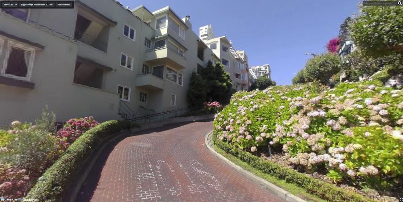

Google Street View in CesiumJS at Lombard Street in San Francisco, California, USA
Google Street View in CesiumJS, at Lombard Street in San Francisco, California, USA.

A panorama with both Street View and Photorealistic 3D Tiles.
