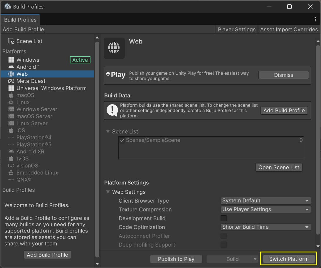

1Switch the project’s platform to Web. This can be done through File > Build Profiles. Select the Web platform, then, click Switch Platform.

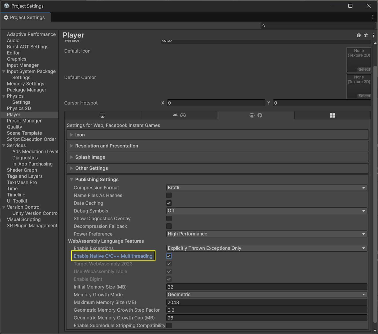

2Click Player Settings in the top right of the window. Scroll down to the Publishing Settings section, and then check the box next to Enable Native C/C++ Multithreading.
Information
If you miss this step, you will see linker errors later when attempting to build your project. They'll look something like this:
wasm-ld: error: Library/PackageCache/com.cesium.unity@57778A6EB39E/Plugins/WebGL/libCesiumForUnityNative-Runtime.a(CesiumCreditSystem.cpp.o): undefined symbol: __wasm_lpad_context
wasm-ld: error: Library/PackageCache/com.cesium.unity@57778A6EB39E/Plugins/WebGL/libCesiumForUnityNative-Runtime.a(CesiumCreditSystem.cpp.o): undefined symbol: _Unwind_CallPersonality

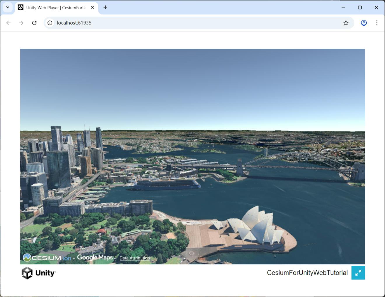

Once compilation is finished, Unity will launch a web server to host the built application. It will also launch a web browser to connect to the web server, and your application will appear.
The application running in a web browser.

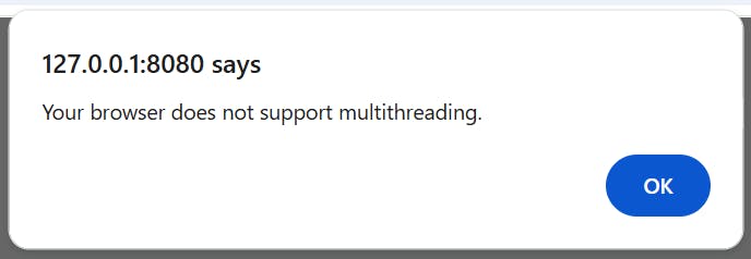

Cesium for Unity's use of native multithreading requires that the web application run in a secure context. This is established by the hosting web server including specific headers in its responses:
  • Cross-Origin-Opener-Policy: same-origin
  • Cross-Origin-Embedder-Policy: require-corp
  • Cross-Origin-Resource-Policy: cross-origin
If your web server does not include these response headers, the application will display an error when it launches:
Your web browser does not support multithreading.

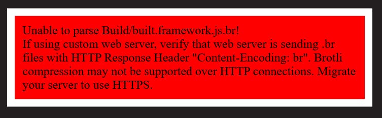

By default, Unity uses Brotli compression to minimize the size of the files that must be downloaded before running the application. It gives the compressed files the .br file extension. Modern web browsers have built-in support for decompressing Brotli, but they will only know to do so if the web server tells them. Specifically, all .br files must be served with the following HTTP response header:
  • Content-Encoding: br
If this response header is missing, the application will report an error at startup.
Unable to parse Built/built.framework.js.br! If using custom web server, verify that web server is sending .br ffiles with HTTP Response Header "Content-Encoding: br". Brotli compression may not be supported over HTTP connections. Migrate your server to use HTTPS.
Depending on the web server, this may not be easy to do. It's not enough to simply add the Content-Encoding header to all responses; it must be added to only the .br file responses.

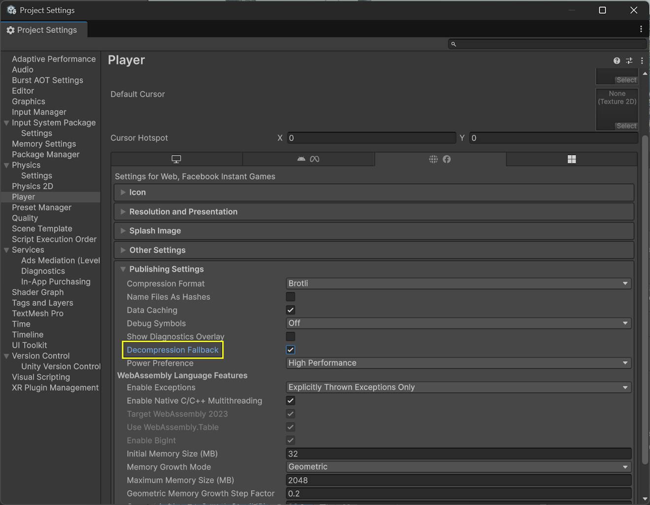

If this is difficult to arrange for your web server, there is a workaround. In Unity's Player Settings, enable the Decompression Fallback option.
Enabling the Decompression Fallback option.
With Decompression Fallback enabled, Unity inserts code to detect when the .br files are served without the proper response header, and manually decompresses them. This works well, but will increase application startup time.
