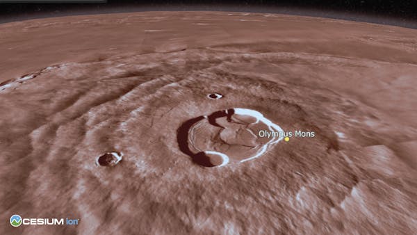

A Complete, Readily Accessible 3D Dataset of Mars
Cesium Mars is complete 3D Tiles of the Martian surface that enables 3D visualizations, simulations, and analytics to support advanced digital twin creation. Cesium Mars combines terrain captured by NASA's Mars Global Surveyor spacecraft and the European Space Agency's Mars Express spacecraft with the Mars Viking Colorized Global Mosaic imagery into a single tileset.
