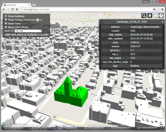

The 20,000 buildings stream in based on the current view, and are individually selectable. When a building is selected, the CyberCity and Bing REST APIs are queried to display metadata. For example, here is City Hall:
Cambridge City Hall.

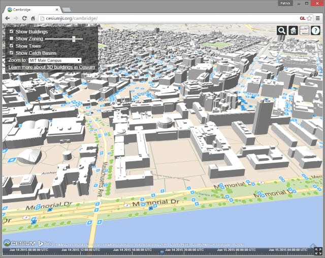

Some of my other favorite views include the MIT Campus and Central Square.
The MIT campus along the Charles River with the Barker Engineering Library in the center. Like the buildings, the trees and catch basins are also individually selectable.

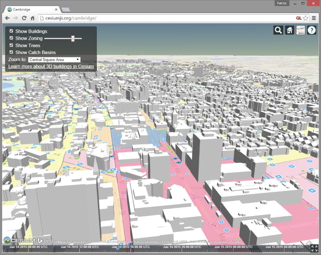

Looking west from Central Square.

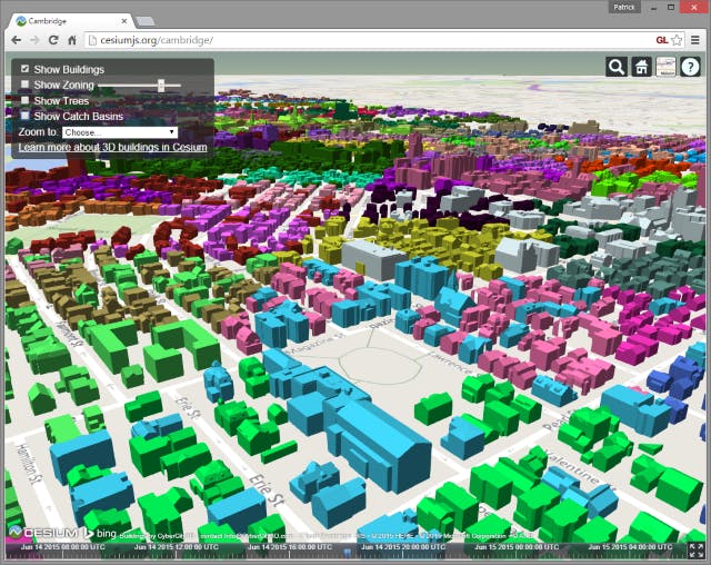

The buildings are streamed using Binary glTF, which was released in Cesium 1.10. Buildings are grouped together into tiles to reduce the number of network requests and WebGL draw calls.
Buildings colored by tile.

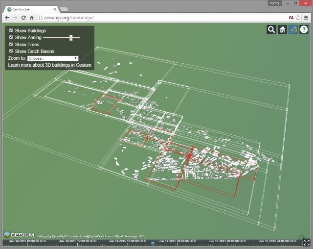

Instead of using a traditional quadtree, tiles are adaptively subdivided to take into account the non-uniform distribution of buildings.
Tile bounding boxes. Note the high detail in the southeast, and the low detail in the northwest, based on the current view.
