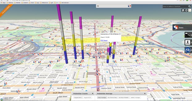

There is a great open-data movement in Philadelphia, but there is not a one-stop viewer for the heterogeneous datasets. Our goal was to develop OpenPhillyGlobe as an open-source web-based 3D globe for visualizing Philly’s open data with an initial focus on simultaneously visualizing multiple transit layers.
OpenPhillyGlobe, showing real-time locations of SEPTA buses and pedestrian traffic data.

The outcome of our efforts was a prototype of the OpenPhillyGlobe that aggregated several data layers, including the real-time visualization of SEPTA buses, SEPTA rail routes, pedestrian traffic counts, and bike theft data. Any of these data layers can be enabled to construct a hybrid dataset tailored to the end user. In building this application, we applied and demonstrated several key Cesium features, ranging from DynamicObject representation of SEPTA buses, to Geometry and Appearance rendering of pedestrian data.
