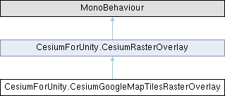

Inheritance diagram for CesiumForUnity.CesiumGoogleMapTilesRasterOverlay:
CesiumForUnity.CesiumRasterOverlay
