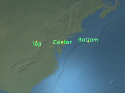

verticalOrigin :VerticalOrigin
Gets or sets the vertical origin of this label, which determines if the label is to the above, below, or at the center of its position.
Example:
// Use a top, right origin l.horizontalOrigin = Cesium.HorizontalOrigin.RIGHT; l.verticalOrigin = Cesium.VerticalOrigin.TOP;Source: Scene/Label.js, line 537
